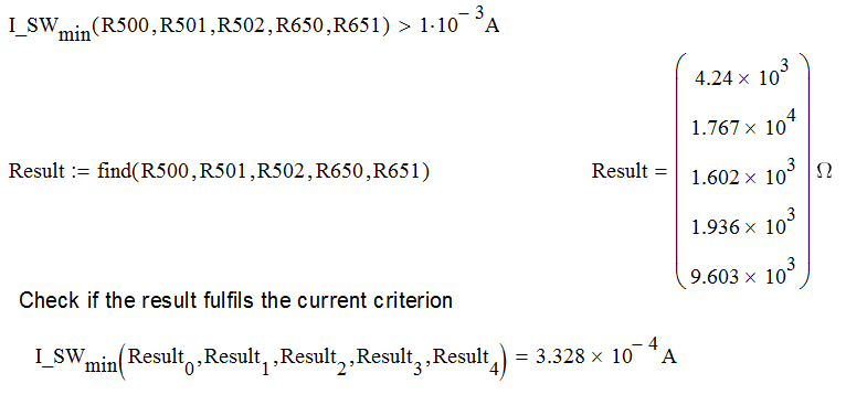

I am working on a problem in MathCAD 15.0. I am Trying to find the solution to a system of inequations
I am using the given...find() block
I have successfully defined my constants, functions and constraints and at the end of the block I get some result which is partially good with the stress on partially.
I have several constraints and some of them mgiht be contradictive. I was prepared that the set of constraints that I have defined could yield a "no solution found" but the solver gave me a solution instead which does not fulfill all constraints.
Unfortunately I cannot share my work but this attached picture demonstrates my problem quite well.solver.PNG
My questions are therefore:
  • What determines which constraints are kept and which will be violated? (I tried moving the contraint around to see if the order matters but I had no luck)
  • Is there a way to control the priority of contraints? (e.g.: create hard and soft requirements)
  • Is there a way to disable priorities (i.e.: every contraint must be fulfilled or no solution should be returned)?
Thank you for your kind support in advance!

Try adjusting the system variables TOL and/or CTOL.
See the Help on Find.

It was indeed CTOL.
I somehow interpreted it to be a relative and not absolute number.
The CTOL=0.001 was therefore obviously too large for a constraint of I>1mA
Now I do get "no result".
