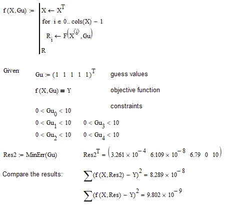

You may try a solve block with "minerr" to do the job.
As you can see the fit is not as good as the one without the constraints and Mathcad holds the last two vector elements of Gu hard at their limits (0 and 10).
