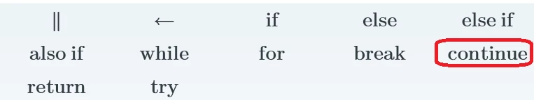

I have only one Mathcad-sheet with continue programming operator. I can show it!
But we can creat this program without the continue operator. But with the continue operator it is nice, fine, прикольно!
Do you have or do you seen a Mathcad-sheet with continue priogramming operator?

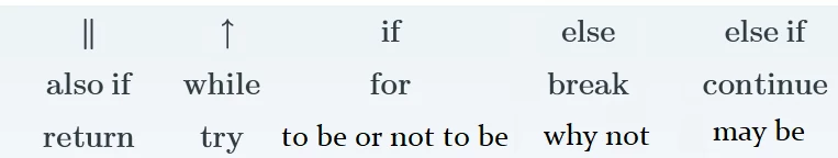

My own programming palet for Prime (fuzzy sets)

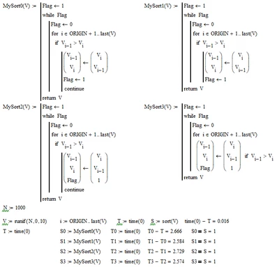

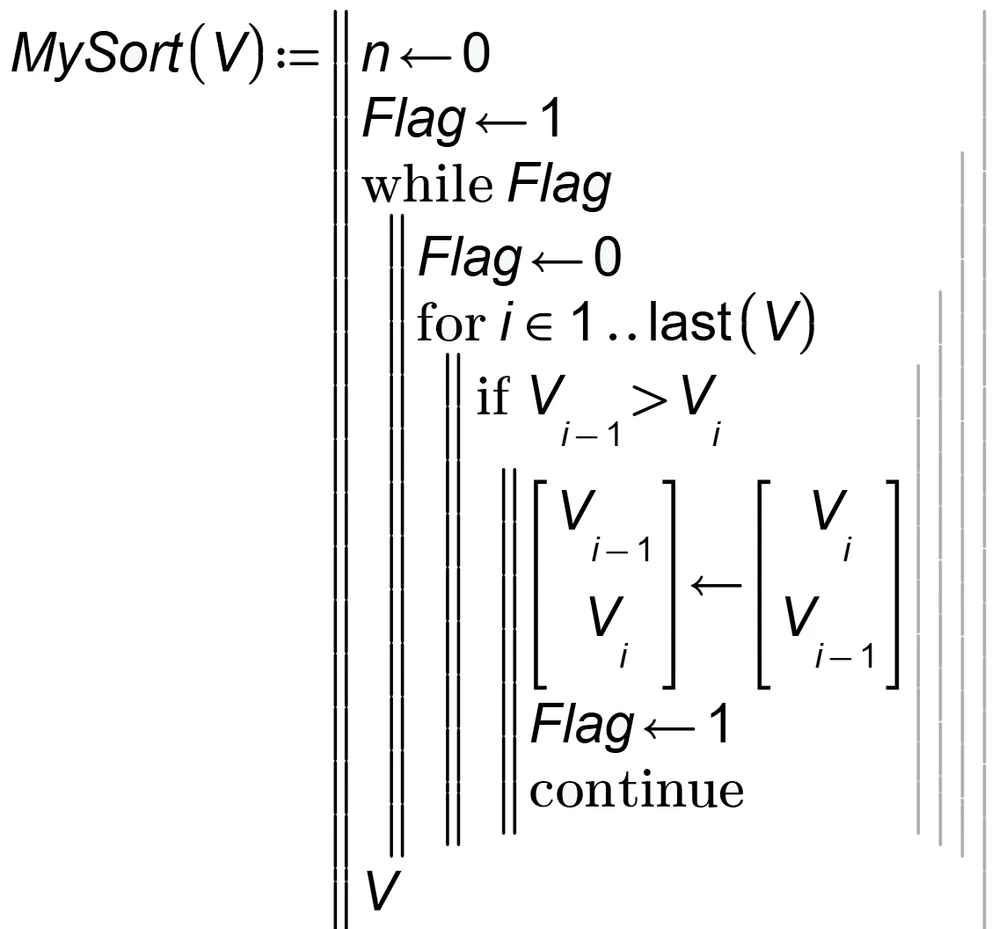

What is purpose of the assignment to n (the first statement of the program)?
The program runs with the same result, but faster, without the continue statement.

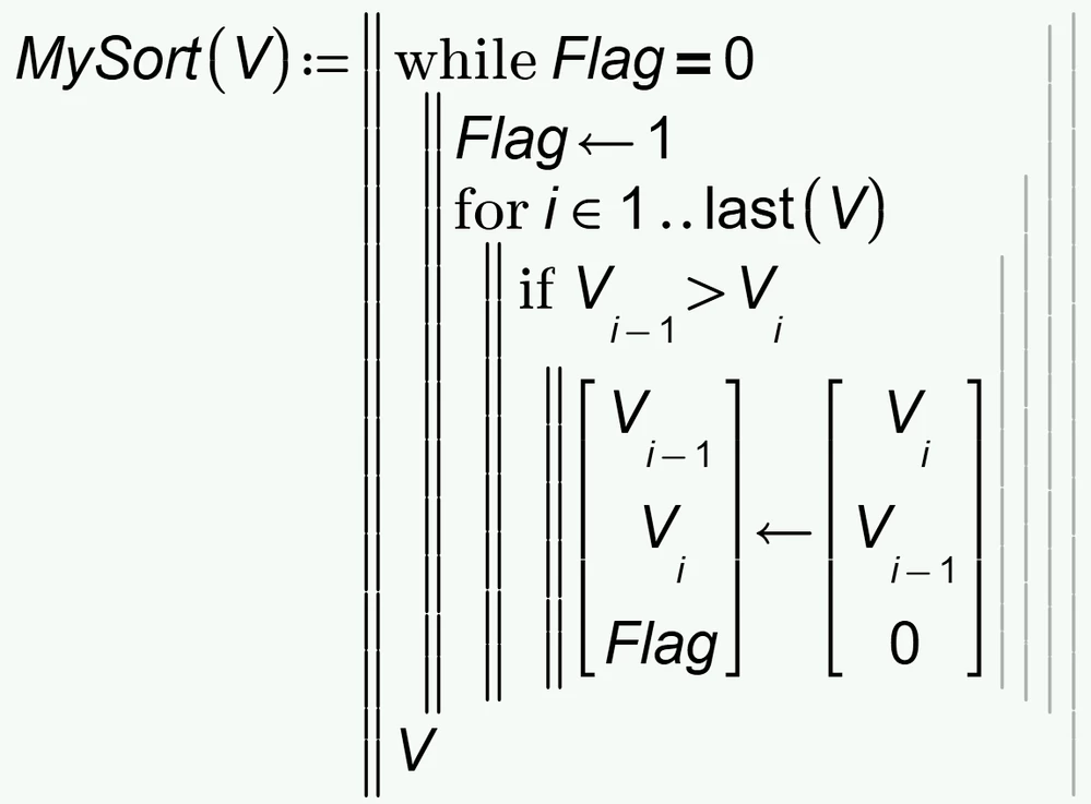

And it can be speeded up a little more by integrating the assignment to Flag into the vector assignment:
