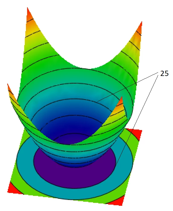

I have done so for one article - manual with Paint

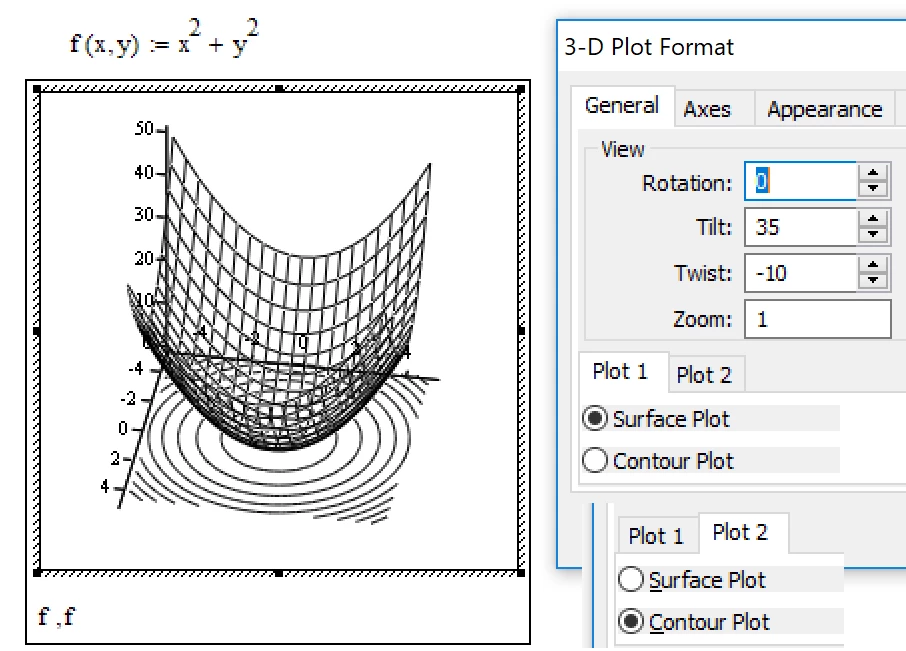

You create a second surface plot for the legend using the minimum and maximum of your data and hide arguements on second plot.  From an earlier post.  Mathcad and PDF
