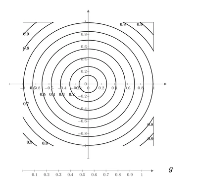

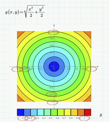

Werner_EAnswer
Jul 21, 2022 1:23 PM UTC
If C should be the level then C its NOT part of the function term, but its rather the curve resulting from the implicit function f(x,y)=C.
Which function f?
A single  contour plot of f should shou you a couple of level curves and you can control how many and at which space by editing the first, second and last value of the legend below the plot (its rather clumsy to do).
In the pic below I highlighted the values you can edit to achieve the desired effect. Prime sure makes it unnecessary complicated to get a certain number of contour lines.
You can also turn off the color scheme and turn on the level values

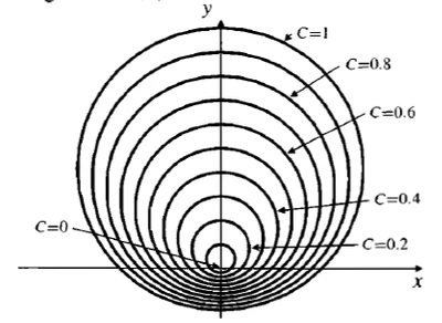

Sergey15-MoonstoneAuthor
Jul 21, 2022 1:04 PM UTC
It is indeed a family of the level curves as shown in picture below.
