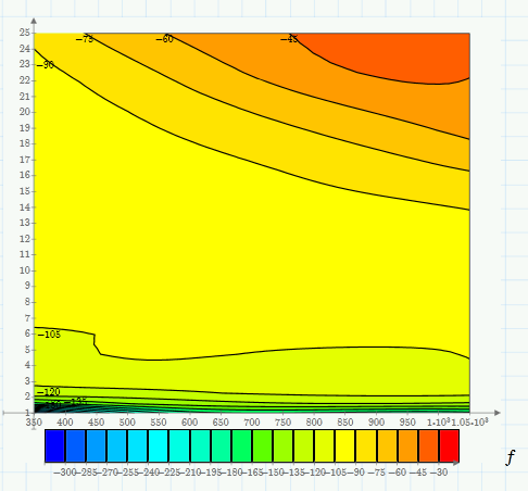

Regarding the contour plot you get at least your color strip legend.
See here a pic from a file of from recent thread ( http://communities.ptc.com/message/203136#203136)

Thanks Valery and Werner that is just what I wanted. I don't have Prime installed and Valery's link didn't let me open the .xmcd file so I am still not sure how the colour caption was inserted. Is it just a second contour plot with the same maximum and minimum as the parent plot? It would be ver helpful if I could see the code?
