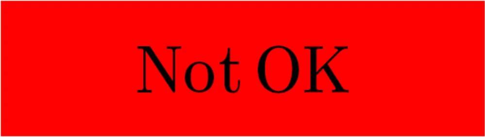

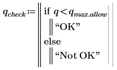

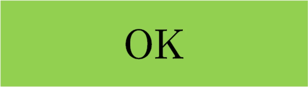

Controlling on the color of the result.
Hi everyone, I hope you are fine.
I need to change the color of the result word, if it was safe to be green and red in case of unsafe.

Werner says like this one.
t.t.
