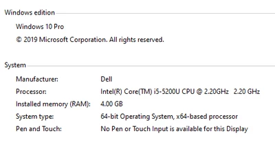

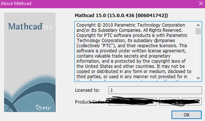

Below are my office Mathcad (with legal license) and OS (with legal license) information.

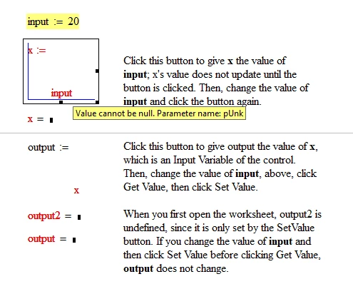

1. when I open the quicksheet "Controls and Automation" (Ibelieve you can find the quicksheet in mathcad folder, anyway i save as and upload it), the button does not work. see below screenshot

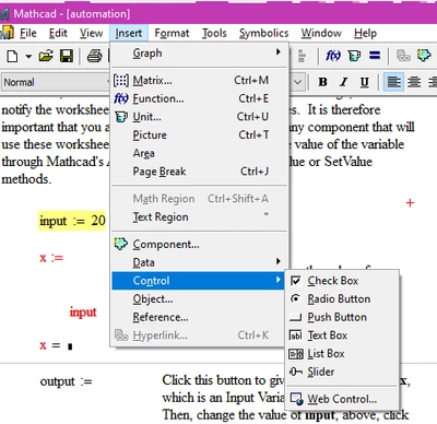

2. Another problem is that when I Insert -> control -> Push button (or other controls or Web control...), nothing apears. Also, Insert -> Data -> Table, nothing apears.
But my own home computer(Win 10 OS). Mathcad (Mathcad15, need check details) works well without above kind of problems. So for the compatibility, I need avoid to use controls. This is very inconvenience and make sheet to be lower leavel... I try to find solution for years from internet and F1 help. But can not solve the problem.

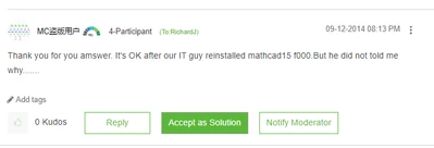

I remembered I posted a same topic when 2014:
https://community.ptc.com/t5/PTC-Mathcad/why-the-controls-are-disable-in-my-sheet-Mathcad-15-F000/m-p/360932#M141178
But the difference is in that post the problem because our office OS update from winXP to win7. And after IT guys reinstall Mathcad, in Win7 OS, the controls problem were solved. Now this time in this post, the OS is Win10...
The Mathcad is still Mathcad 15 F000
Any chance to upgrade from F000  ("F" means the first release of version 15) to a newer maintenance release (current and last is M050)?
I am not sure though if this would cure your problem as I assume that at home you are using F000 as well without problems, right?
