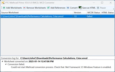

I need to convert a file, but I'm concerned about not being able to convert the hundreds of old files that I have as well.
When I tried to convert the file, I got this error message.

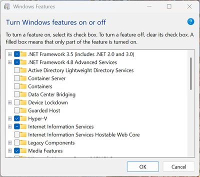

I've verified that the framework in installed.  I've uninstalled it and reinstalled it.
I've rebooted the computer, ran updates, and rebooted again.  I still get the same error message.

Solved.  I had to uninstall mathcad prime and reinstall it.  Then the conversion worked.
