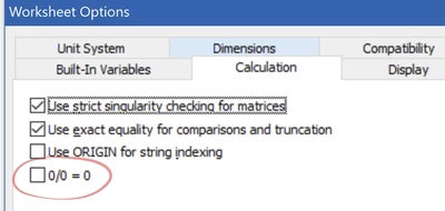

Best guess is that in MC15 in the Worksheet Options the option 0/0=0 is checked.
As far as I am aware there is no comparable option in Prime.

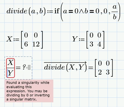

A possible workaround could be a small utility function which is called vectorized:
If thats not the cause of problem you would have to send the MC15 sheet and maybe also the Prime sheet.
