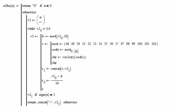

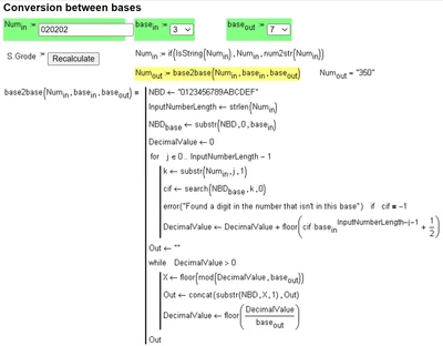

The attached Prime file contains a number of functions to convert radix (between binary, octal, decimal and hexadecimal, or an arbitrary radix in the range 2 to 16).
Some examples are provided.
May 9, 2022 10:55 AM UTC

I am not sure which file or which thread you are referring to?
But maybe the files posted by Terry and Luc are already what you are looking for.
EDIT: I just noticed that you replied to a post of mine  in this thread https://community.ptc.com/t5/PTC-Mathcad/Umrechnung-von-Dualzahlen-in-Hexadezimalzahlen/m-p/620705/highlight/true#M186669
An eager moderator felt he needed to fork your  reply to this older thread and create a new one. Unfortunately, this was done without referencing the old thread and thus the reference to the post to which you had referred was lost.
EDIT 2: After informing mod about this, the remark "Related to this thread:" was added at the top of the first posting here.
Attached is the file mentioned in the other thread, converted to Prime 6 format so it should open fine with newer Prime versions.
