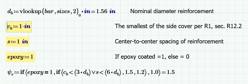

Convert 1x1 vector to scalar in if statement
In the attached Prime worksheet I am trying to use the "logical or" function within a nested if statement. I believe the error is due to db being a 1x1 vector. Is there a way to convert this from a 1x1 vector to a scalar value?
23-Emerald V
Daniel Sochor wrote:
...r. Is there a way to convert this from a 1x1 vector to a scalar value?
Just use the standard vector index ... v[0

Thank you Stuart
