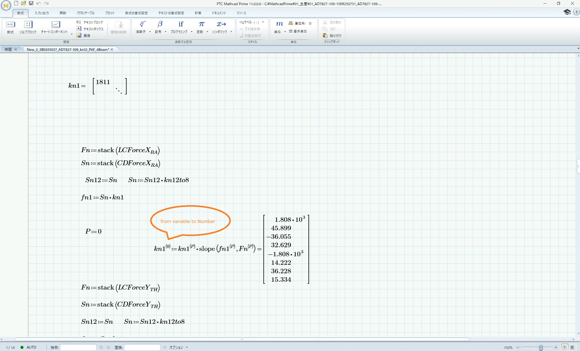

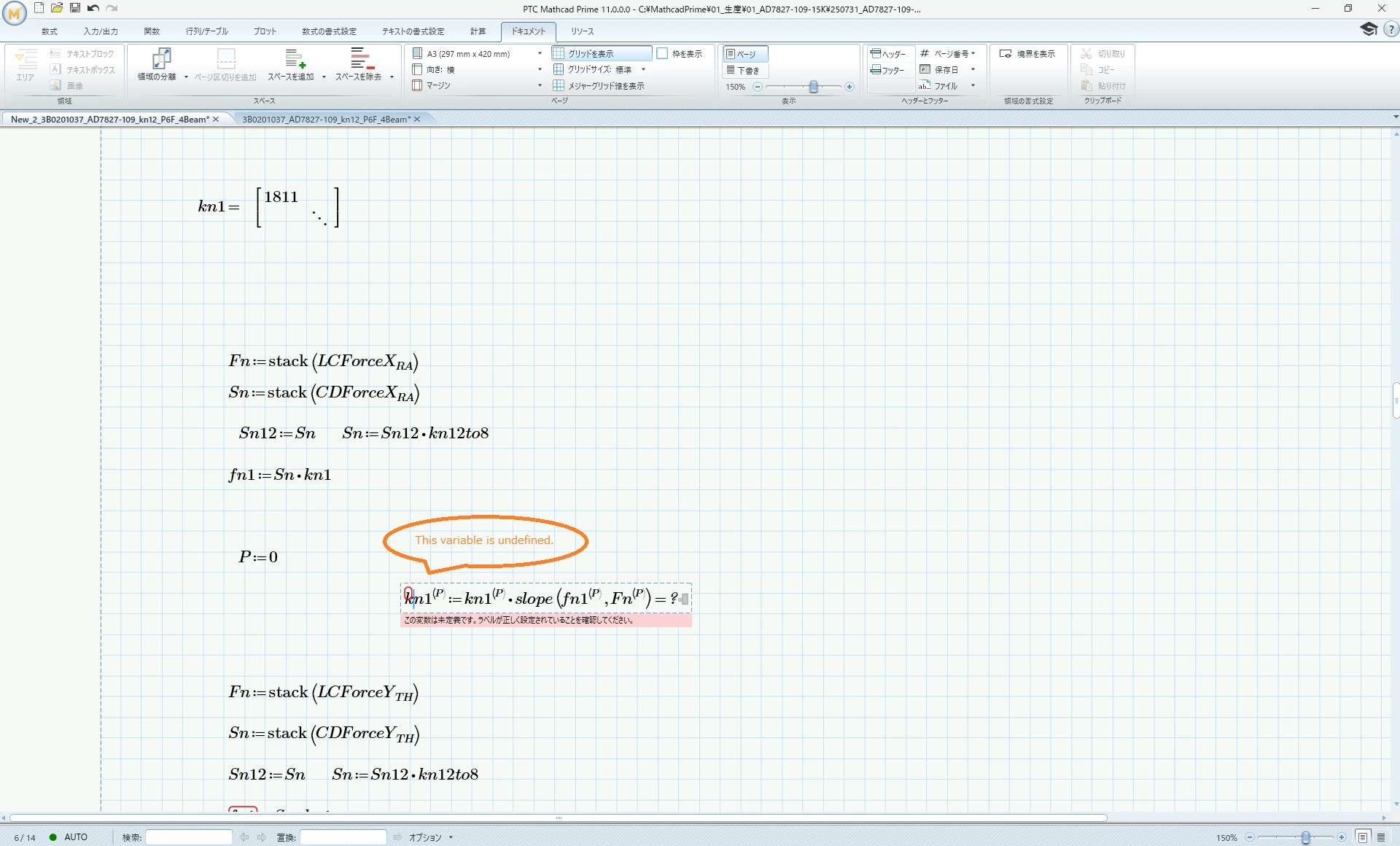

Converting from Mathcad 14 file to Mathcad Prime 11.

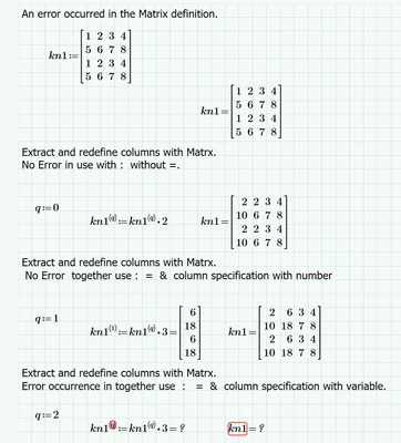

An error occurred when extracting and redefining a matrix by specifying a column.
Changing the matrix column specification from a variable to a number does not cause an error.
Why is the error occurring?

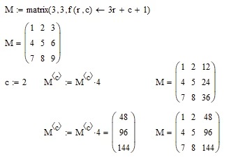

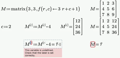

I couldn't resist and gave it a try and its as I suspected:
Prime 11.0.0.0:
Real Mathcad 15:
While it was already a good advice in the old real Mathcad to avoid inline evaluations, the problems seem to have gotten even worse in Prime.
I would call it a bug, and you are free to report it as such to official PTC support—good luck!
BTW, the bug is NOT present in Prime 6 and below. Can't say anything about Prime 7 and 8 because I never had installed these versions.  But the bug definitely shows up in Prime 9, and also in version 10 and 11.0.0.0. Can't say anything about the current version 11.0.1.0 as I have not installed it and PTC is not able/willing to publish a comprehensive list of bug fixes or improvements  made in their various versions.
But at least you now have a work-around - avoid inline evaluations.

Unfortunately, it isn't easy to debug a worksheet from an image.
Have you tried deleting the P:=0 expression and retyping it?
If you go to the Math tab in the Ribbon and you should see a "Labels" dropdown in about the middle of the ribbon.   Click on the P in the P:-0 definition and note its Label.  Then click on the P in the kn1<P> term and note if it has the same Label.  Labels are the Mathcad Prime equivalent of Mathcad 14 Styles, but they differ significantly in how they work, and they might not be correctly converted.

Thanks your reply..
I've created a simplified example..
Is this a limitation of Mathcad Prime?
