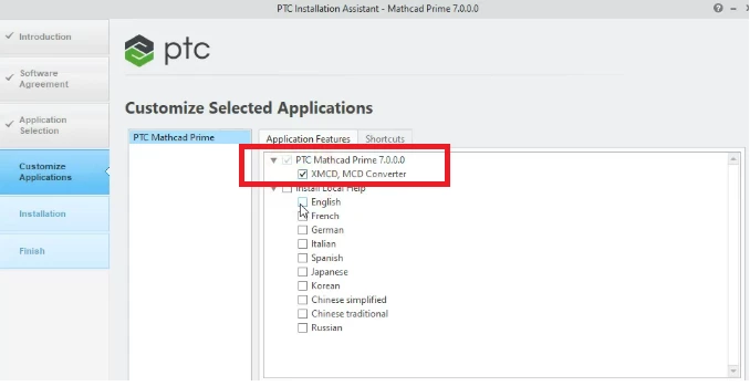

Prime 8 comes with an integrated converter so you don't need MC15 anymore.
When you install Prime, the converter is NOT enabled by default. If you missed that you can run the installation again and check the box to include the converter.
