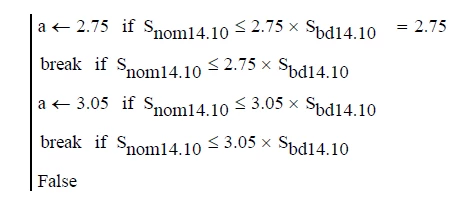

Am converting some existing Mathcad 15 files to Mathcad Prime 2.0 but have come across an issue where by the "break" programming syntax does not work in the same way and I can not figure out a way to replicate the level of functionality required.
Any ideas from the community? Image and example file attached.

It's a poor program structure even inMC15, where it works! Better to program this as:

The break is normally used to break out of for/while loops.
I fully agree with Alan's response. An alternative might be as shown in the attached.
