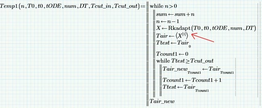

Hi all,
I am attempting to extract a vector element piecewise within a while loop and assign it to the while evaluation variable for test.  I am able t do this once before I enter the loop but I cannot do this once in the loop and I get the "Array index is invalid message".  Is there a way to conveniently extract the element and assign it to the evaluation variable?  I am not a strong coder, clearly, I do not understand something.
Any help would be greatly appreciated.

Hi, zero based array indexing is the default.  With one unknown only have columns 0 and 1
23-Emerald I

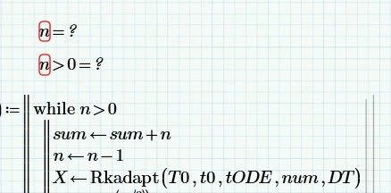

You have an undefined variable " n ".  You test for n>0, which fails so the Rkadapt never executes.
n is delivered as the first function argument.
