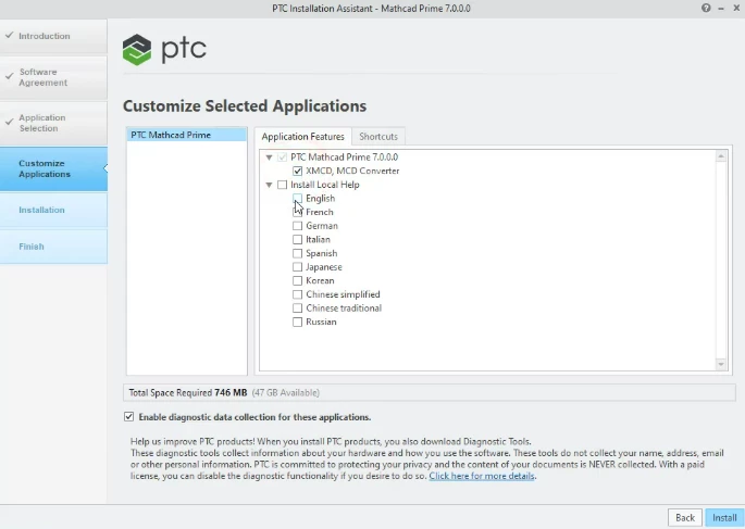

Converted using PTC Mathcad Prime 8.
Starting with PTC Mathcad Prime 7, you don't need a license of legacy Mathcad to convert legacy worksheets, provided you installed the converter tool when you installed PTC Mathcad Prime 7 or 8. It's a separate checkbox that is unchecked by default. If you didn't check it, you can reinstall Mathcad Prime to do so.
PTC Marketer for Creo and Mathcad. I run their YouTube channels, some Creo campaigns, and all Mathcad campaigns and communications.
hsrao771-VisitorAuthor
I only have Mathcad Prime 6,0,0,0 and the converter is also installed but it requires Mathcad 15 software also to be installed for conversion!
