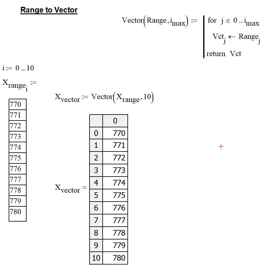

January 22, 2021
Hello  AshehadAl,
Please see the uploaded jpeg graphic.
