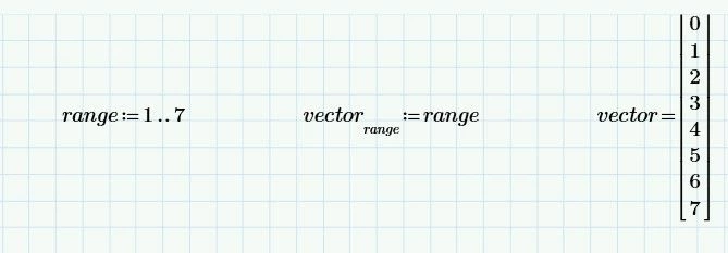

Another simple way is:

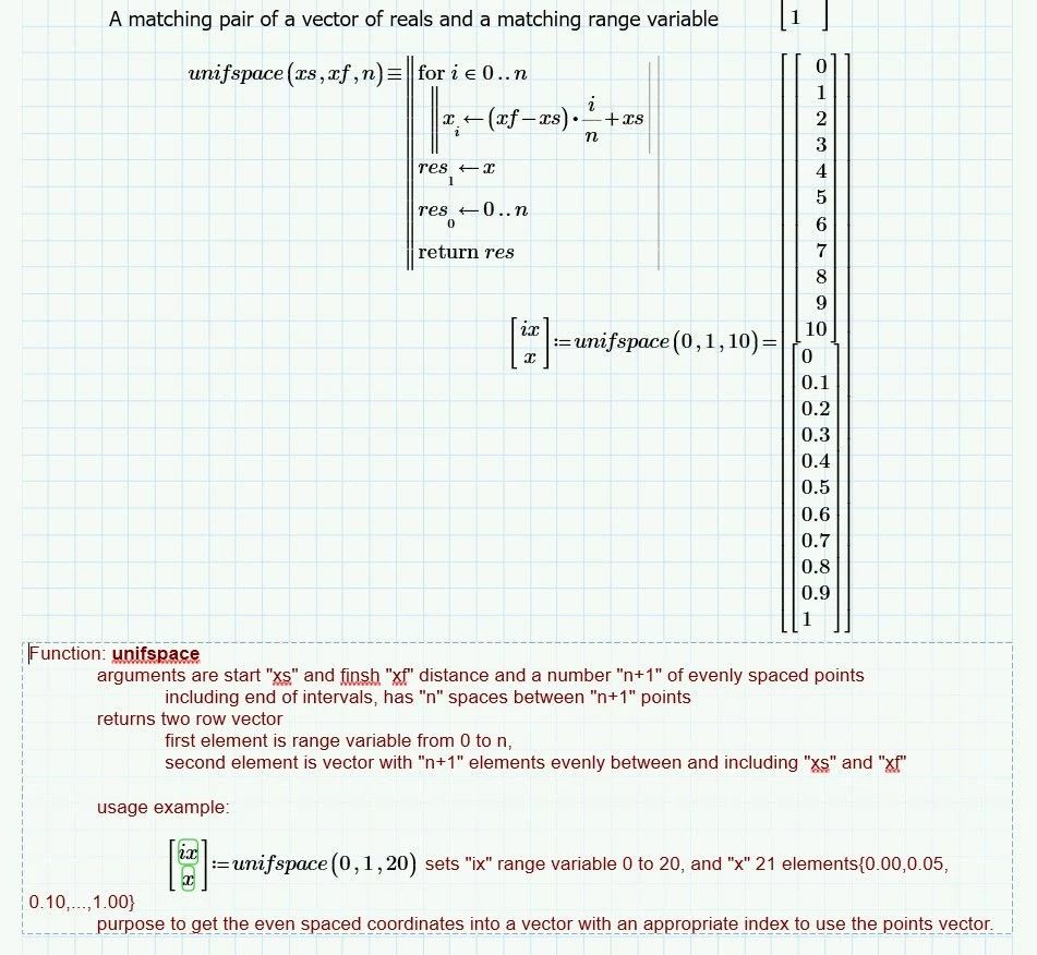

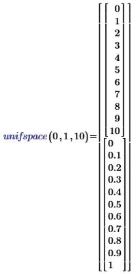

An alternative for unifspace, which also works for Prime Express is:
Example:
