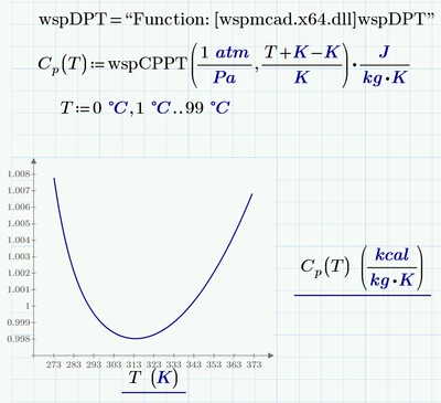

Yep.  That's .045% relative error in Cp between IF97 and IAPWS-95.  To be expected.  These are the differences between IAPWS-95 and IF97.
The IF97 computational validation points match the verification points in IAPWS R7-97(2012) to 8 decimal places in most cases.

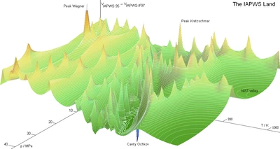

One my fine picture
