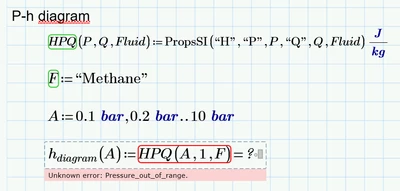

I am trying to get a pressure-enthalpy diagram for methane by using Coolprop but I am constantly getting Pressure_out_of_range error. Does anyone know the solution?

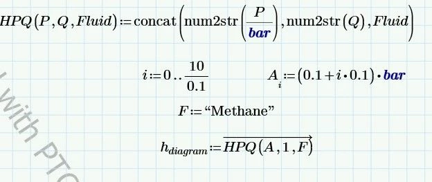

Do not Have CoolProp so made up a make do HPQ function for this example
You first need to create a vector (not a range) for A.
Then vectorize the calls (element by element) of A when using HPQ
Cheers
