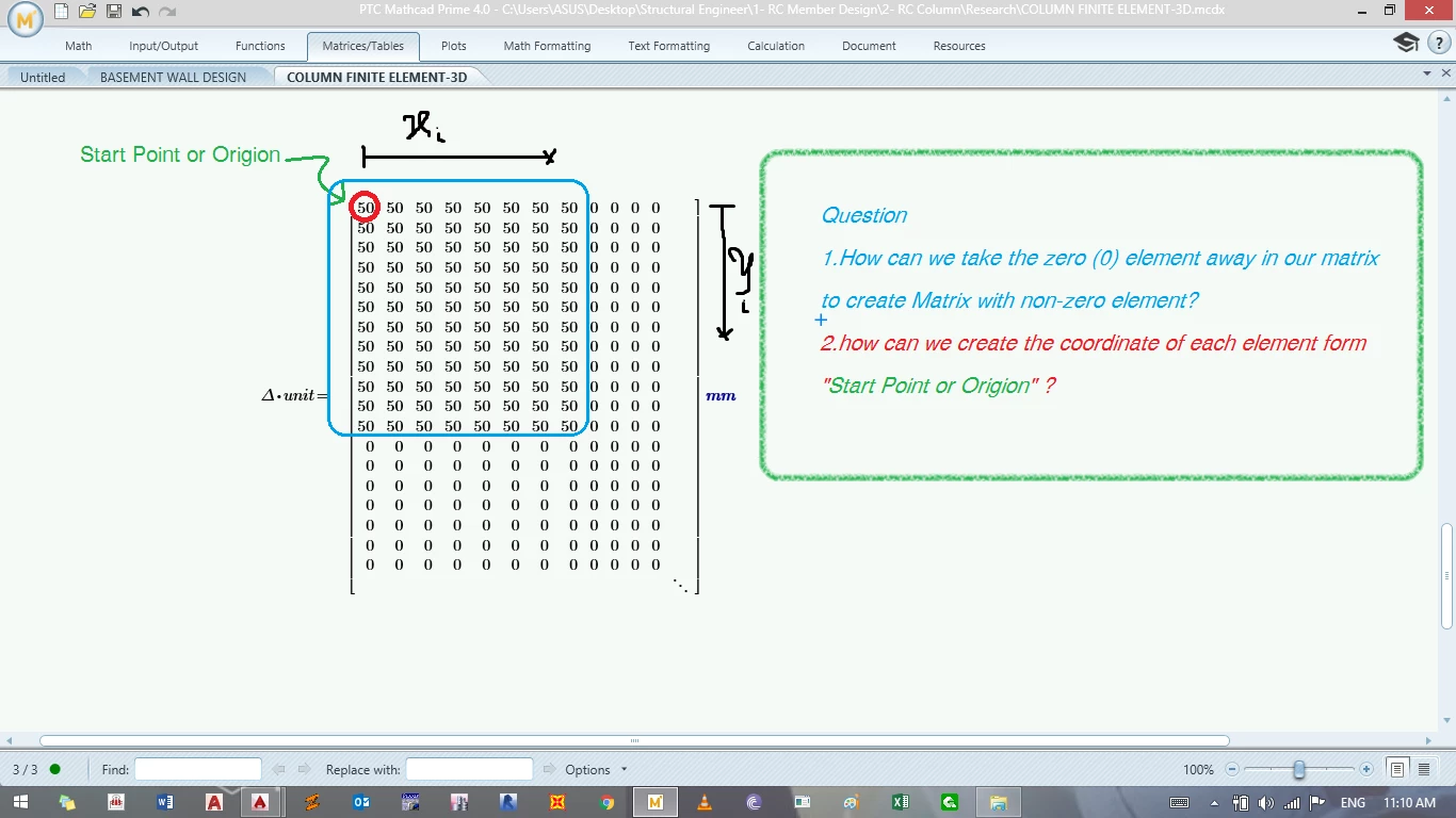

Dear Everyong,
I have 2 Questions to you all help to some keys to me. (have attachment)
1.How can we take the zero (0) element away in our matrix to create Matrix with non-zero element?
2.how can we create the coordinate of each element form "Start Point or Origin" ?
Thank you for your help.
Best regard
Phearun

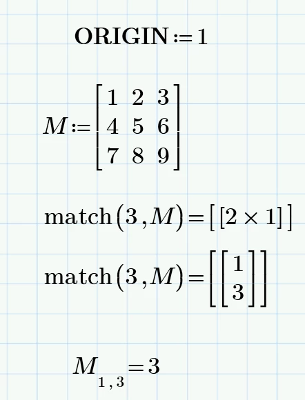

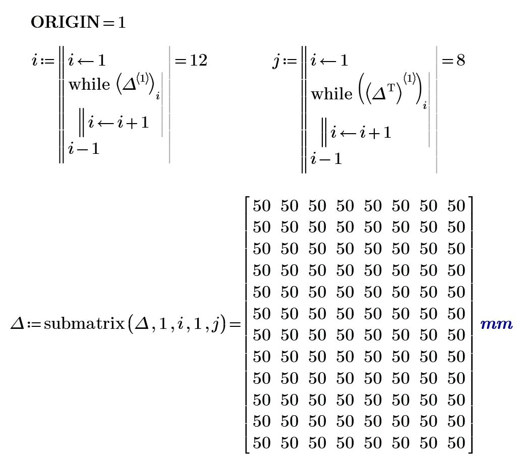

March 24, 2018
One solution

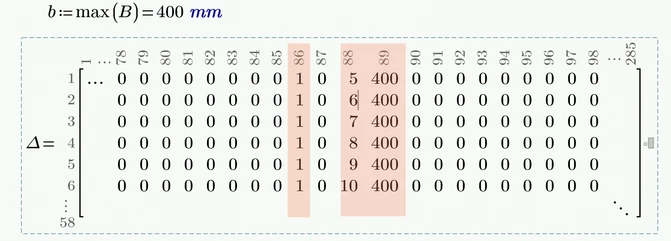

You say that you want to discard all zero values in your matrix, but what about the non-zero values in columns 86, 88 and 89 ????
Why do you extract that many data from your excel component just to delete them immediately afterwards?
