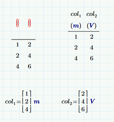

I highlighted a group of cells in excel, copied and pasted them into Prime, and it put "red paperclips" across all the cells at the top. I don't need the whole document, just a few cells to form a table, so I don't know if I should use the insert command or not

When you copy and paste from EXCEL to Prime, Prime creates a "table,"  the "red paper clips" are a request for a variable name.  (Underneath the variable name is a place for units.
