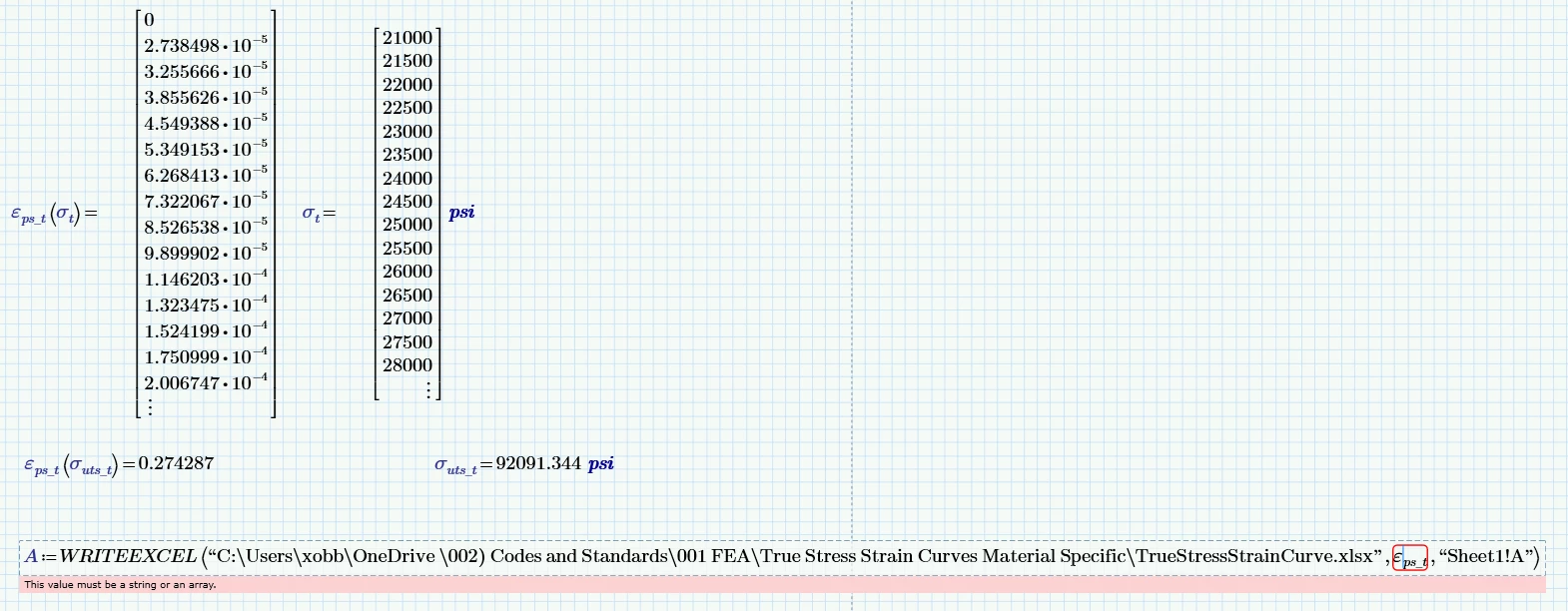

eh it has a problem when i try to build it for ε_ps_t.  it says it must be a string or array.  any ideas?

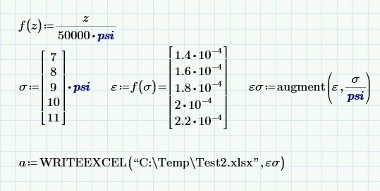

You need an array to save to Excel.  Your picture shows a strain function used in place of an array.  You can omit the range as the WRITEEXCEL function defaults to this if not specified.
Do it like this.
