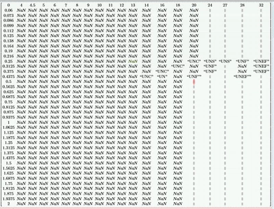

I'm making a thread calculator.  In order to check whether user input returns a 'typical/standard thread combination' or not (e.g. UNC, UNF, etc.), I want to have a master check list matrix, probably with a vhlookup.
I'm lazy and don't feel like copying EACH element NaN...is there no way to select a bunch and copy it into the next row/column?
I can copy multiple entries and paste a nested into one entry location, but not copy them over into multiple elements.

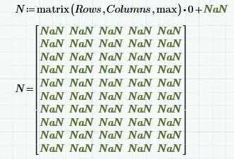

You can use either function to create the matrix of desired size, and fill(ed) with an arbitrary value (replace NaN with any value you like). Then you evaluate the matrix (M=      or N=)
Then you should be able to copy the matrix created to the definition of a new one. After that you can delete the matrix creation and its evaluation and work on the definition of your matrix: changing some NaN's to another value.

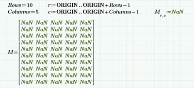

But there's another option as well. You can keep the matrix creation and additionally set the desired matrix elements to a value of your desire. If you keep that in a collapsed area, you have the whole thing documented:
And, before I forget. The simplest method to create a matrix with Rows rows and Columns columns is:
(That is:
- If the Matrix M didn't exist already, or, if it did exist, was smaller in both dimensions.
- If you've not changed ORIGIN from its default value, otherwise ORIGIN can only be 1, and you omit both "-1" in the creation.)

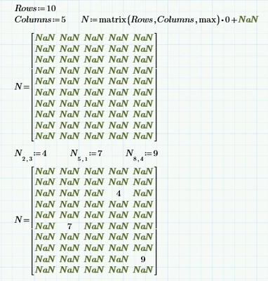

Two possible options come to mind easily.
1.
2. (much simpler)
Prime4 file attached.
