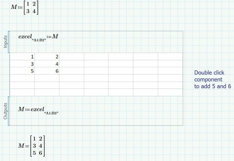

Like this:
Cheers
Terry

terryhendicott
Jun 9, 2022 12:37 AM UTC
Just tried an experiment.
You can cut and paste from Excel to the Excel component.
Select cells in Excel
Copy Cells
Double click the Excel component in Prime, this opens up Excel.
Paste Cells.
Add your data to the Excel component.
It also works in reverse to copy from Prime to Excel. Don't forget to double click the Excel component to open an instance of Excel.
Cheers
Terry
terryhendicott
Jun 9, 2022 12:50 AM UTC
Like this:
Cheers
Terry
