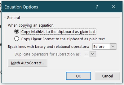

Thanks for your reply. Just because Microsoft's equation can export as MathML. And Mathcad Prime sheets are saved as set of XML files. But you are probably right that there is no straightfoward solution.
