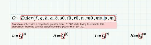

You an improve the situation with m(t) by multiplying numerator and denominator by exp(-10(t-10)).  For example:
Alan
23-Emerald V
May 2, 2020
It's the exponential in your m(t) expression blowing up.

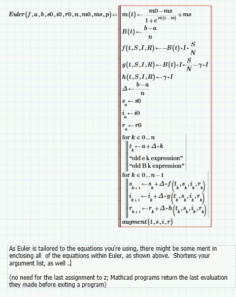

If you want to use B within your program, you'd probably be better of defining it as a local function at the top of the program (B(t)<-m(t)*p
Stuart
23-Emerald V
May 2, 2020
Just as a quick follow-up to my previous post, here's one possibility for making Euler a bit easier to use (as it's already tailored to your problem, it's a reasonable option).
Unfortunately, I've only got Prime Express so can't run programs, but you should be able to check it making B return 5 (to behave like your earlier, simpler Euler function).
Stuart

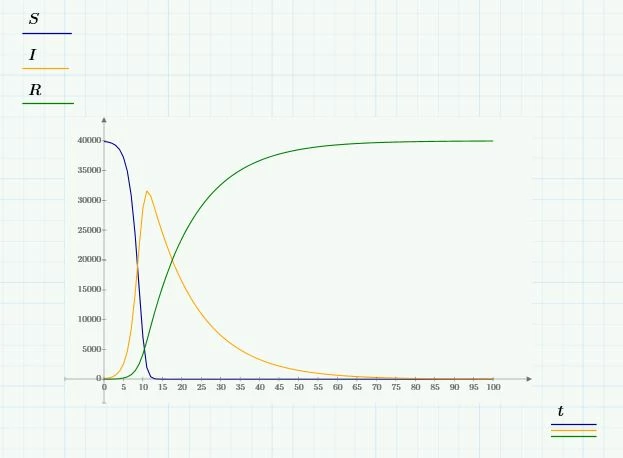

Thank you! I now have a more streamlined program that is at least plotting but the curves just settle around iteration 11. The graphs should look like the image attached. It that program I had a constant value for 'm' but now I want to do one that varies as a function of time.
