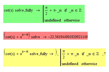

cot(x) + e^(x - pi) solve, fully ?
Hello Everyone.
From :
I.PNGThe "yellow" is my question. Thanks in advance. Regards.

Oh..., the answer of the my question is : "No". My bad.

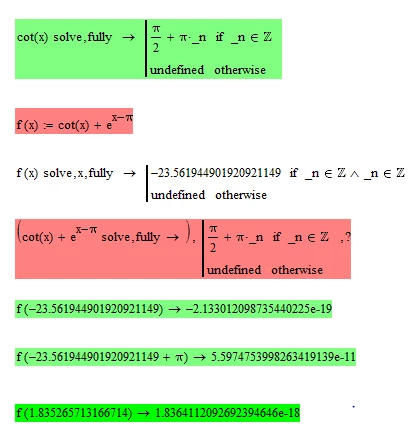

But I guess it has one more solution. This make me confuse.
Regards.

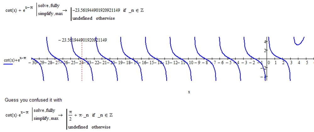

Guess you mixed up + and *
The function you provide is not periodic and the symbolic result is not wrong but by far not all 😉
