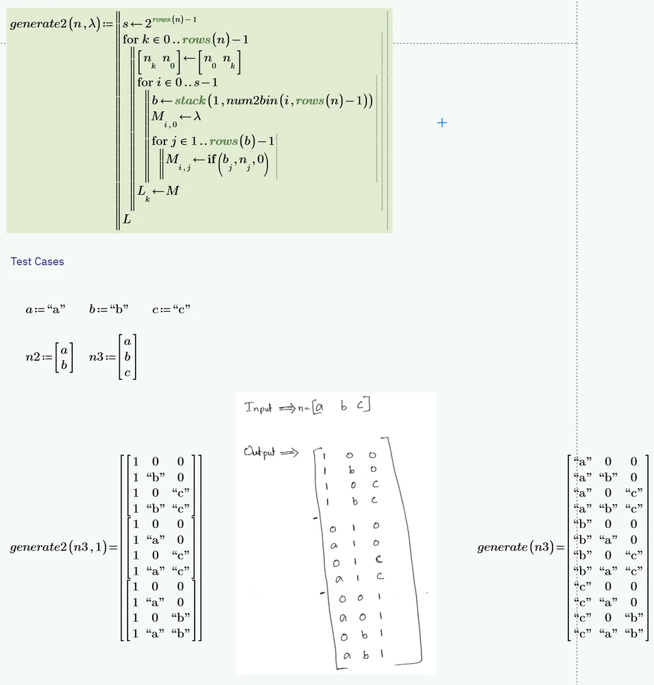

Could you help me to program this one
Hi
could you help me to program this one?
And the previous generated function works without m to (mod..).
see the picture.

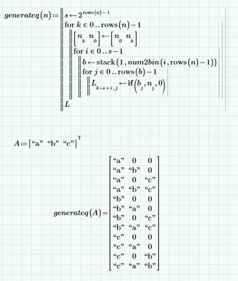

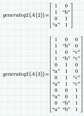

And again you are just posting one single handwritten example and are  not willing to explain in more detail which rules apply to return this output from the given input? Is there anything you tried on your own (apart from retyping Stuart's program)?
Is this homework? Or where does this problem stem from?
Can only guess that you are looking for something like this:
23-Emerald V

As a starter for ten, however ...

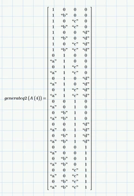

An "obvious" pattern from your example is to replace each leading row element of generate with 1 and then "shift" the leading row over to the jth column.   It might be helpful to break this down into smaller steps by creating a submatrix for each kth subgroup of s permutations.   generate2 shows one method of partitioning L.
There are several ways to stitch the partitioned L back into a single matrix (eg, stacking subsequent partitions onto the first).
