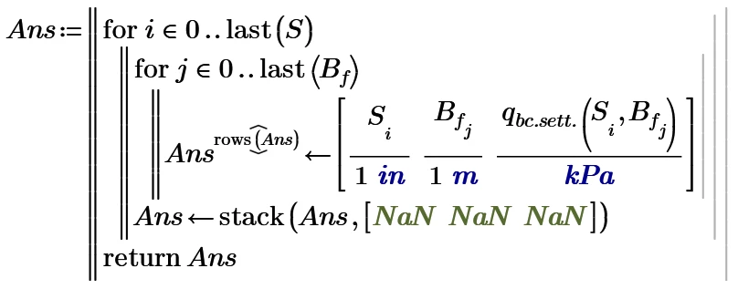

Thank you @ttokoro . What is purpose of using third brackets " [  ]". Is this for assigning the matrix values in each corresponding cells inside the "Ans"
ttokoro
Jul 13, 2023 1:18 AM UTC
Your sheet shows error mesage for x and y data must have no unit. So I make Ans as [x y z-value with unit].
And stack all S and Df  and  its Ans.
I try to use [NaN NaN NaN] to stack. In this plot, z axis also has no unit.

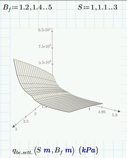

In fact, the error message reveals the cause and also gives the hint to the solution of the problem:
The variables for the independent variables (x, y) must (unfortunately) be unitless. Only the dependent variable (z), i.e. the function result, may have a unit.
So omit the unit meter at the range variables and add them when calling the function.
The plot takes "endless" to finish because the function seems to be defined quite inefficient.
You sure should consider to implement the improvement I suggested in another thread of yours which at least speeds up the calculation for the factor 5.
Personally I would prefer using CreateMesh() instead of range variables

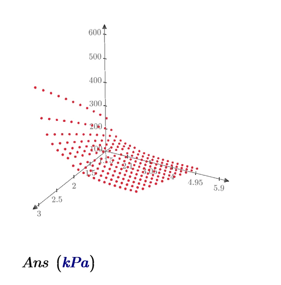

Thank you @Werner_E . Is it possible to make the plot as individual dots
Jul 13, 2023 2:18 AM UTC
Sure! Simply format the plot that way
I used the data  structure created with CreateMeashj() but you can do the same with the plot using the range variables.

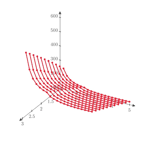

ttokoro
Jul 14, 2023 10:57 PM UTC
t.t.
fahmed-214-AlexandriteAuthor
Jul 15, 2023 12:38 AM UTC
Thank you @ttokoro.  Looks amazing!!
