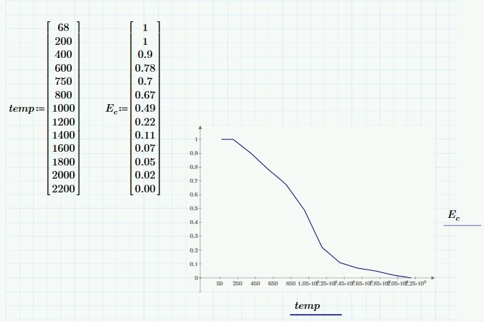

Create a function for line graph values?
In the attached Mathcad prime 3.1 worksheet (along with screenshot) I've graphed two vectors in an X-Y plot. Is it possible to create a function such that the user can type in any value for temperature( within the highest and lowest value) and receive the temperature back?

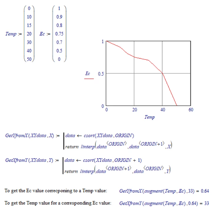

That's what you asked, but not what you meant to ask....
I'm afraid you want a function where you give an Ec value, and get the correcponding temperature. That is partially possible.
I think the answer to your question lies with the function linterp(), look it up in the help, and see how it works.
The problem is that there is a temperature range where the Ec value is 1. What temperature would you expect to get for Ec=1?

Here's an example using linterp().
Note that it works because there is a one-to-one relation between Temp and Ec values. If that is not the case (as in your example where Ec=1 on a range of Temp values), the linterp() funtion will complain. In that case using spline functions (see the answer below) may (...) help.

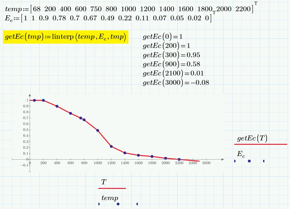

My guess is that you want a function to calculate Ec from a given temp and not the other way round.
If linear interpolation is sufficient you may do like this:
