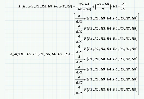

I have a function that depends on several variables, and I want to compute the partial derivative with respect to each variable and store the results in a matrix.
For example, the variables R1​,R2​,R3​,R4​,R5​,R6​,R7​, and R8​ are known.
F(R1, R2, R3, R4, R5, R6, R7, R8)=R5*R4/(R3+R4) +(R7-R8/2)*R1+R6/R2
I would like to create a matrix A_dif such that:
A_dif(1)= dF/dR1
A_dif(2)= dF/dR2
A-dif (8)=dF/dR8
Can this be done so we do not need to repeat the operation 8 times.

You can.  It's a lot of typing!.
3-Newcomer
Feb 3, 2026 1:57 PM UTC
I had this as a solution, but I was expecting something that uses a for‑statement, because sometimes my functions have 100 variables. I would like to automate the process.

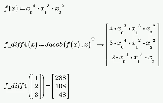

Feb 3, 2026 2:11 PM UTC
A function with 100 arguments?

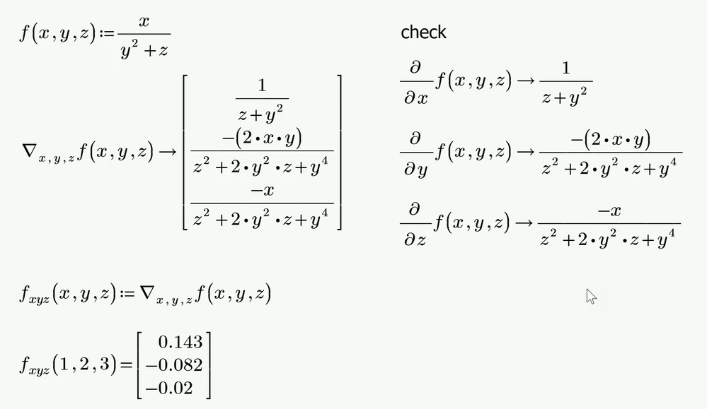

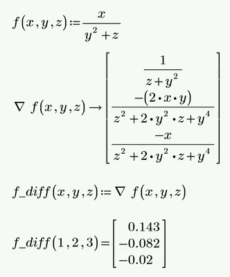

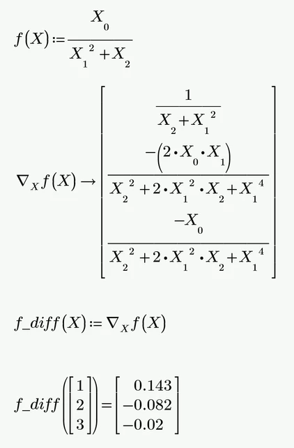

So these arguments better are provided via an input vector instead of listing them individually.
As an example the same demo function with three arguments as posted before

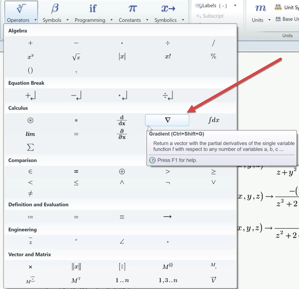

P.S.: I am not sure if the gradient operator already exists in Prime 8, though.
EDIT: I just check and it seems that the gradient operator was not present in Prime 8
See: Solved: Representing Del Operations [curl(u), div(u), grad... - PTC Community
The operator actually was introduced in Prime 9.
Any chance you can upgrade your version of Prime?

This is what the Nabla/Gradient operator is to be used for. Can be used symbolically but also numerically

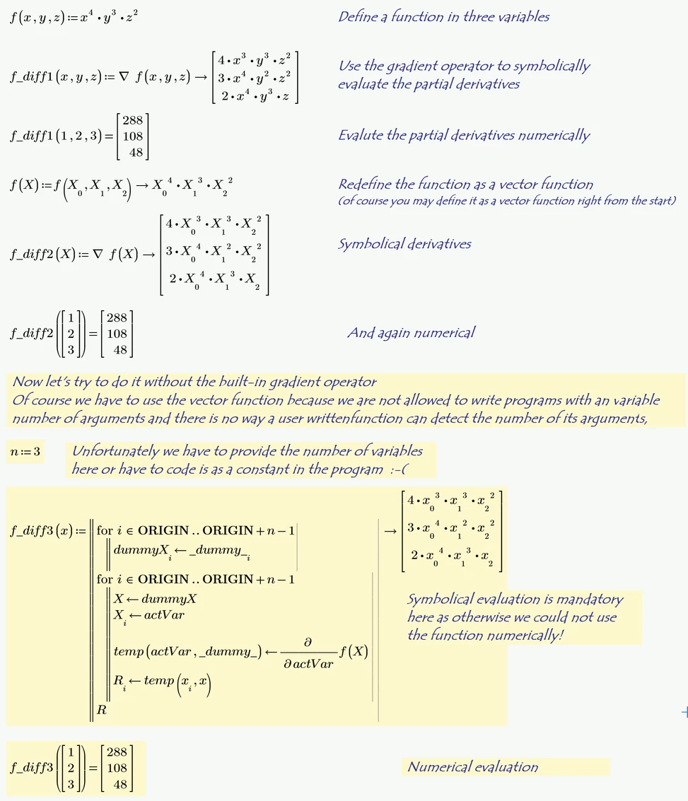

I'm afraid that there will be no convenient option in your version of Prime, as Prime does not provide all the necessary features—it does not allow vector elements as derivative variables and, unlike the old, genuine Mathcad, it does not allow symbolic evaluations within a program.
So if you don't have the option of upgrading to a newer version of Prime, it will probably be difficult or rather impossible to achieve.
As a supplement to what was shown earlier: If partial differentiation is to be performed for all variables, it is not necessary to list all variables individually in the Nabla operator; instead, the corresponding placeholder can be left empty in this case:

OK, I gave it a try and here is my best approach to automatically get all partial derivatives without using the gradient operator.
The method sure has its drawbacks and if ever possible you should switch to Prime 9 or higher where the gradient operator is available.
The attached file is in Prime 11 format as I don't have Prime 8 installed. However, you can certainly follow it based on the screenshot.
Hope it works OK in Prime 8 and can be of help.
LucMeekes23-Emerald VAnswer
23-Emerald V
Feb 4, 2026 7:43 AM UTC
Werner's file converted to Prime 8. I had to take the gradients out, as they wouldn't convert.

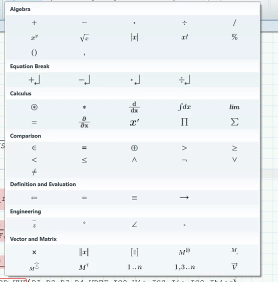

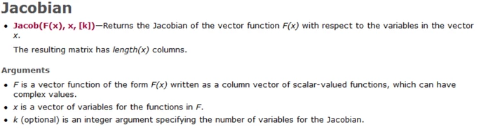

I'm using Express, and Jacobian is not available, but I think it may give you what you're looking for.Fred_Kohlhepp_0-1770259258364.png
Feb 5, 2026 4:32 AM UTC
Its not how 'Jacob' usually would be used for but IMHO its a pretty good idea to use it here and i would say that's the way to go.
It should be available in Prime 8.
Unfortunately it still does need a vector function.
