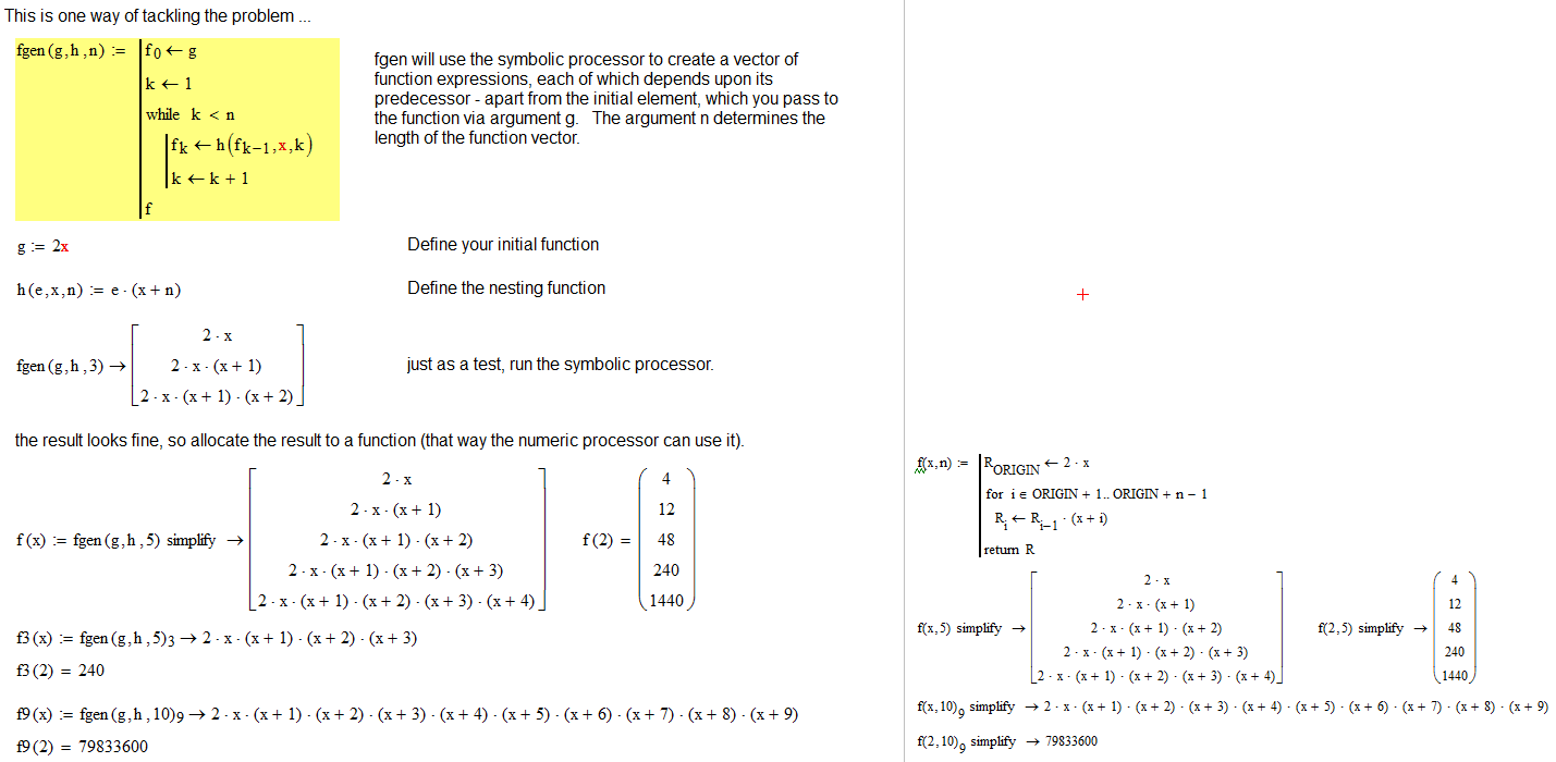

LucMeekes wrote:
The short answer is: no, not exactly the way you describe. The problem is that you cannot grasp the index of an array element inside the definition of the array.
But you can get close. Up to you to decide whether that's close enough. See:
Now, to become independent of a definition of n (the size of the function array), we have to provide it as a parameter:
We can extend it a little bit further by including the initial function and the 'nesting' function as parameters ...
Stuart

What you are asking for does not create an array of functions. It creates an array of numbers. That's possible, but it's very inefficient to calculate an array of numbers up to some arbitrary limit, and then only return one of them. The second function gives the same answer, but only calculates what is necessary.

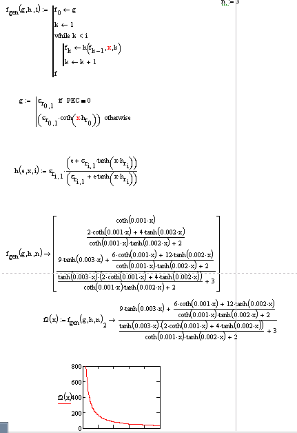

Thanks for the response. I didn't quite explain myself well enough.  I need the incidences within the array to remain a function of X so i can take the improper integral from 0 to inf of the last index. The function is a bit more complex that 2x but I just wanted a general form. The real function I am looking to create uses:
Where ϵr is an array of complex numbers, h is an array of real numbers, and beta is the variable to be integrated. In the real case I actually define the last element in the array as:
and will take the improper integral of the first index (backwards to the original post). I only suggested using a for loop and an array of functions cause I am new to mathcad and didn't see a more appropriate way. Definitely open to a better approach!
Hope this helps.

Thanks for the help!  This may work. In the end I need to take the integral of the final index, so if i can stick f(x,#) into an integral, it should work. I will give it a try!
