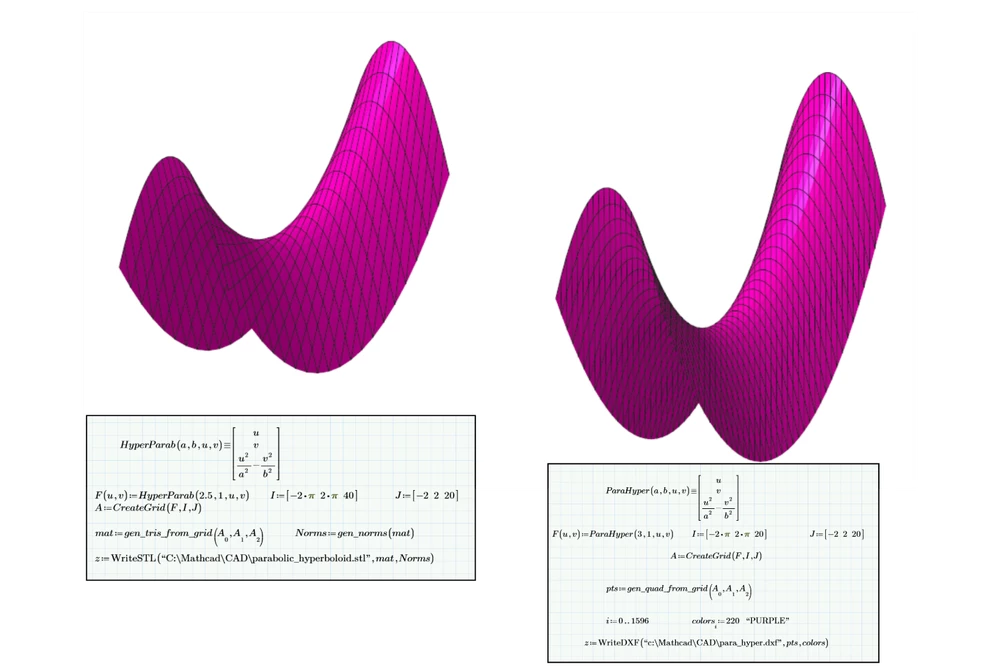

One day while perusing the PTC Community, I saw a post in which someone asked how to create a hyperbolic paraboloid in Creo Parametric. That shape can basically be described as a saddle, and is defined by a straightforward equation. You can find more information about it in this Wikipedia article.
I didn’t have an answer for the end user, but the question always stuck in the back of my mind. You can’t create a surface from an equation. Maybe you could create the boundary curves and a couple internal curves, and then generate a parametric or “technical” surface using the Boundary Blend function in standard mode, or a freeform surface in ISDX.
After I came across the worksheets page in the PTC Community, I decided to give it a try. I modified the equations and write statements to fit the vector equation of a hyperbolic paraboloid. This generated STL and DXF files, which I was able to import into Creo Parametric.
You can see the final result here:geometry-from-mc.png
Pretty cool.
