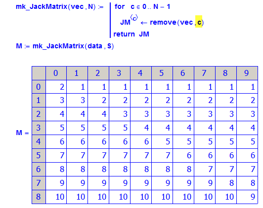

I would like to create a new matrix from the original one that omits a single value from succesive vectors.
I am currently using mathcad 15.
Jan 8, 2015 2:01 AM UTC
It's still not clear what you want. If anything, it's less clear (to me, anyway). Please explain exactly what you are trying to do. Also, when you "remove" a value, what should be there in it's place?
Jan 8, 2015 3:09 AM UTC
Could it be that you are lookin for that change?
