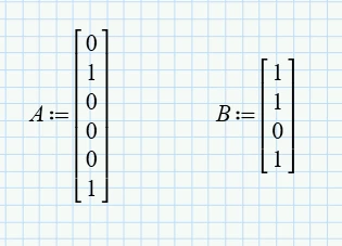

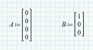

I have a vector [A], which can have any number of even rows and will contain only zeros or ones in each element. I would then like to create another vector [B], which will always have one more than half the number of rows in [A]. The top row element of [B] is always 1, and the following elements depend on the corresponding pairs of elements in [A], working from top to bottom. The element of [B] should be zero only if both the corresponding two elements of [A] are zero, otherwise it should be one. Something like this for a 4 row [A] and 3 row [B]:
And for a 6 row [A] and 4 row [B]:

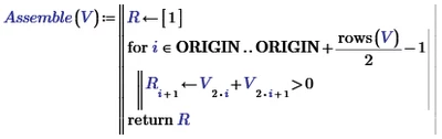

Best answer by LucMeekes
Here's a possible implementation of your function:
Result(s):
If you cannot read the attached file, you must state which version of Prime you are using.
LucMeekes23-Emerald IVAnswer
September 23, 2022
Result(s):

Thanks Luc, that's great!
