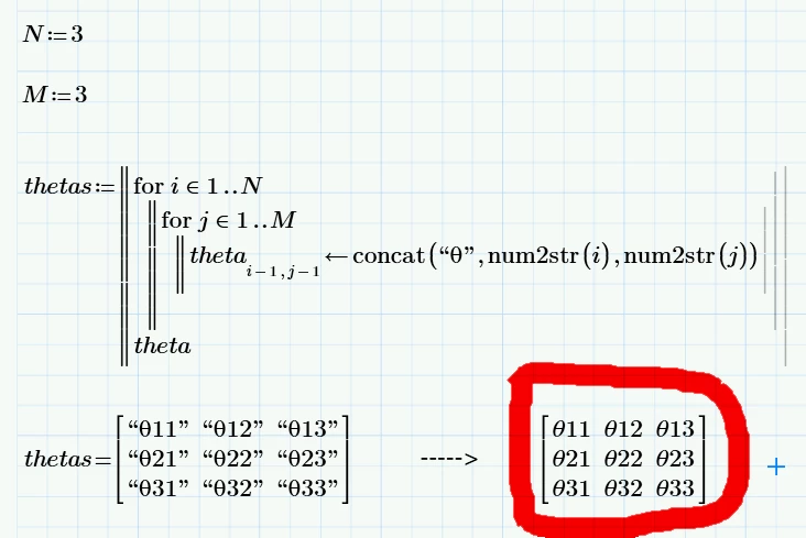

Greetings colleagues of the forum, I have the following query:
How to create variable names automatically?
By programming a loop I get the names of variables but as text strings, I want to get a matrix like the one marked in red?
Is there any way to do it in Mathcad Prime 4?
I would appreciate any suggestions.

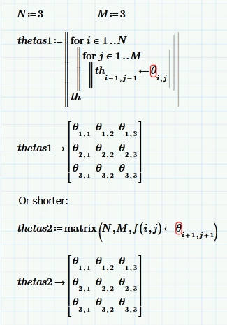

The closest you may come to is using matrix variables.
It depends on your needs if this can be useful for you.

There is a string to number function; but it will not create variable names.  Short of some fancy coding (which Prime still won't do) there's no way.

Hello FredKohlhepp, thanks for your comment. I agree with what you say, I found that in Mathcad 15 there is a script to do it; but the problem is that I'm working with Mathcad Prime on this.

Hello Werner_E, thanks for your suggestion. I had already tried it but since I have to do operations later I get an error and it does not work. However some operations can be performed.
I am reformulating my problem in other ways so as not to have to use numbered variables.
