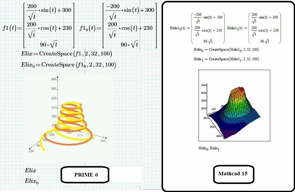

I would like to know, what should I do to make the 3D graphics of Mathcad 15 identical to those of Prime? I attach the two files.
LucMeekesAnswer
23-Emerald V

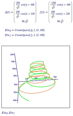

Use a 3D scatterplot.
LucMeekes23-Emerald VAnswer
23-Emerald V
