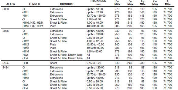

What I'm trying to do is, I have a data for aluminum properties(shown below) where I want to be able to input/select alloy type, temper, and product for that alloy. Then I would like to be able to get the properties of that selected metal. This topic (their Mathcad looks very different from mine, idk why) have asked the same thing that I want(although, I have 3 inputs, while this topic has only one input) but the problem is that couldn't follow the steps in there and am completely lost.

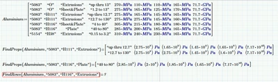

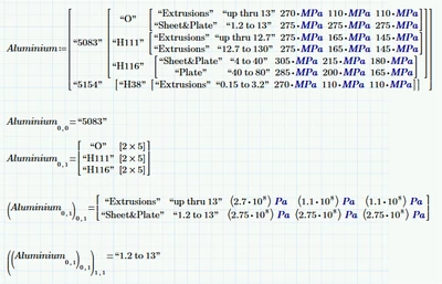

Certainly you may. Here's an example:
Of course you can make the list a simple 2D matrix, which would simplify the adressing to just one level, but it would require that you duplicate your types and other selection criteria throughout.
Here's an example, with a function that extracts data based on three input parameters:

It seems to me that you need further data. The alloy and temper together do not uniqueliy identify the other parameters in most cases.

Sorry, you are right. Yes, and product.
