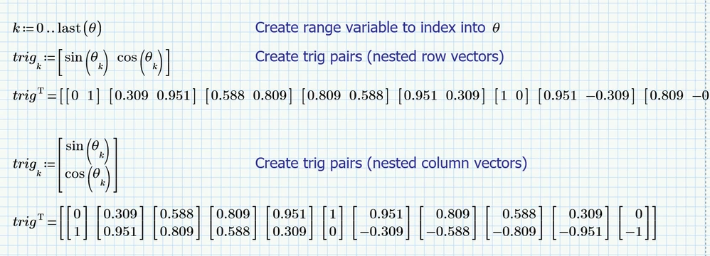

Written in Mathcad 10, but it should work in Mathcad 11.  Just use a direct matrix form to create your nested array pair.   If you want an indexed or programmed version, that's not a problem, but this is possibly the most "Mathcaddy" way of doing it.
You might find it easier to work with the nested column vector form, depending upon your algorithm.

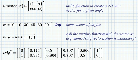

Jun 12, 2025 10:58 PM UTC
Here's an alternative approach using a utility function and vectorization:

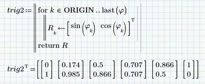

If you more like programming, you can use a for-loop, which basically is the very same what Stuart had achieved using a range variable.
