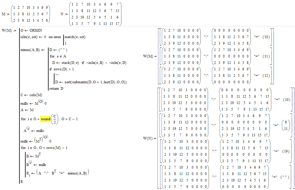

Creating a program function ?
   Hello Everyone.
   Need help with creating a program function W(  ) with the input and a similar output as the above ?
        Thanks in advance.
               Regards.
Werner_EAnswer
Here you are.
If in case of an odd number of columns you want zeros the center column, simply change "round" to "trunc".
What will you do if the number of columns is odd?
Werner_E25-Diamond IAnswer
Here you are.
lvl10720-TurquoiseAuthor
20-Turquoise
Many thanks for your time and help, Werner.
