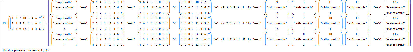

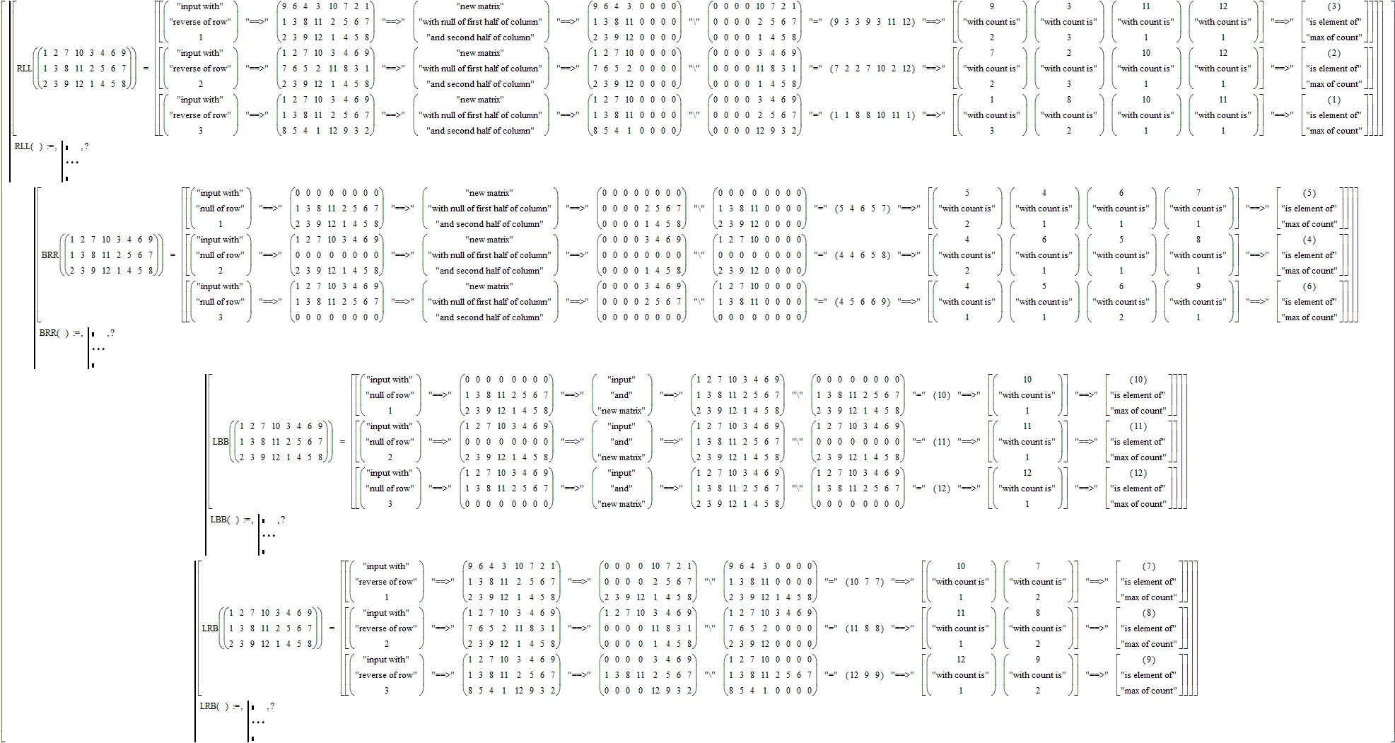

  Hello, Everyone.
   Creat a program function RLL(  ) ?
           Thanks in advance for your time and help.
                 Regards.
Message was edited by: Loi Le

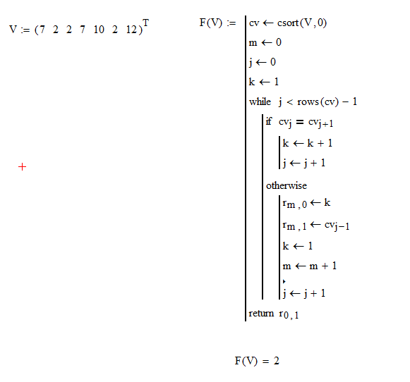

Werner_EAnswer
May 9, 2017

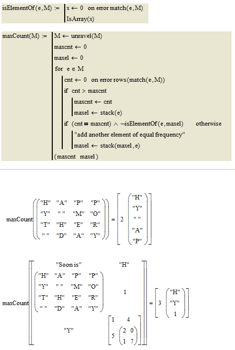

You may use an "unravel" program to use Freds routine:
Or how about this:

What is the question?
lvl10720-TurquoiseAuthor
20-Turquoise
May 5, 2017
   I'm sorry because my question is not clear, Mathcad User.
   I guess Werner who did help me answer some my questions in some previous posts, but the last question I need help is :
   The question is "Create the program function F(  ) ?
          Best Regards.
