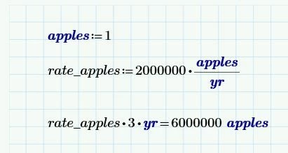

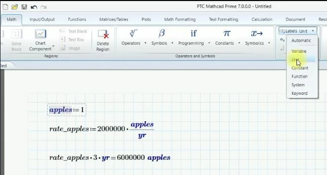

Do it like this:  Define apples as a Unit
Cheers
Terry
