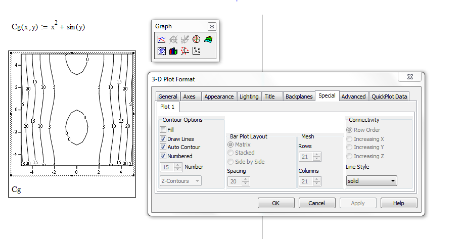

Something like this:
Alan

Yes, that is precisely what I am looking for and figured out how to get that type of plot now, but how do I specify the countours I want? For instance in your plot you have contours of Cg(x,y)=0,5,10,15,20... plotted. I am looking to get contours of Cg(x,y)=0.9, 0.8, 0.7...

Ethan Ambroziak wrote:
... I am looking to get contours of Cg(x,y)=0.9, 0.8, 0.7...
Try it with your function and see if Mathcad comes up with suitable values. I'm not sure you can specify exactly which values it must use!
Post your function (with the ranges of x and y of interest) and I (or someone else) might be able to produce something acceptable to you.
Alan
