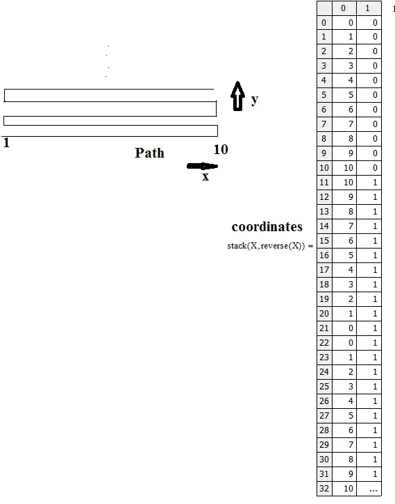

I need to create paths(creating matrix of coordinates) just check image that i have given below is there any simple method to solve this ? this graph has to be plot in x and y coordinates.

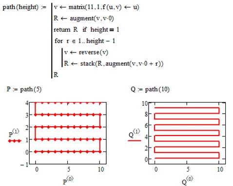

Here is one possible way to achieve what you are looking for:
But if you are only looking for a plot like the figure to the right (with out the intermediate points and with an even number of vertical lines) there might be easier ways to achieve.

But how to control the values, i mean in x and y coordinates values? for example if i want to change from 0.1 to 1 or some other values in both coordinates..

First you have to state if you really need eleven value across horizontally or if start- and endpoint of each horizontal line would be enough.
And then - which value(s) would you like to change? The 0 to 10 across or the upward step of 1?
