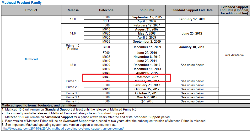

October 13, 2015
Became known to the preliminary release date of Mathcad 15 M045 service release - December 2015 (according to the calendar, link: http://support.ptc.com/cs/product_calendar/PTC_Product_Calendar.htm#RANGE!A549 😞
