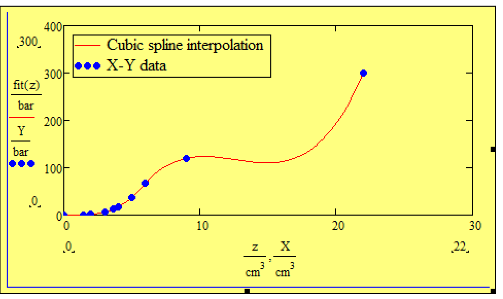

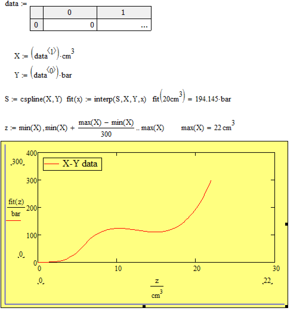

I would like to plot a cspline function with the proper units of measurement.
However as you can see in the attached document (the chart highlighted in yellow) it does not work.

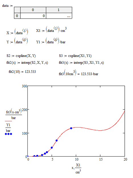

without the use of a discrete variable

You use an undefined running variable z. I guess this means it has no units.
Define z as a range variable with the proper units and I guess it should work as you expect.

z:=1m, 1.01m .. 2m
vkofanov1-VisitorAnswer
