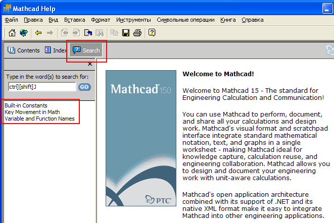

A quote from "Mathcad Help" (see more in attachment):
"[Ctrl] [Shift] J Type characters inside brackets as in chemistry notation.
[Ctrl] [Shift] K Type characters that usually insert operators."

I use so:
http://twt.mpei.ac.ru/ochkov/Mathcad_14/Chapter1rus/44.png

It's a documented feature "chemistry notation".
Search 'ctrl][shift]J' in the Mathcad help menu to find more info.
I wasn't able to find it in the (PDF) manual.
