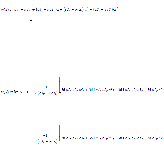

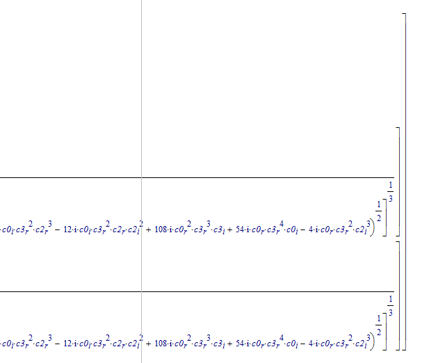

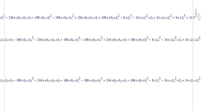

Why not let Mathcad solve it:
the solution is a bit too wide to show here (like some 15 pages) The middle part is

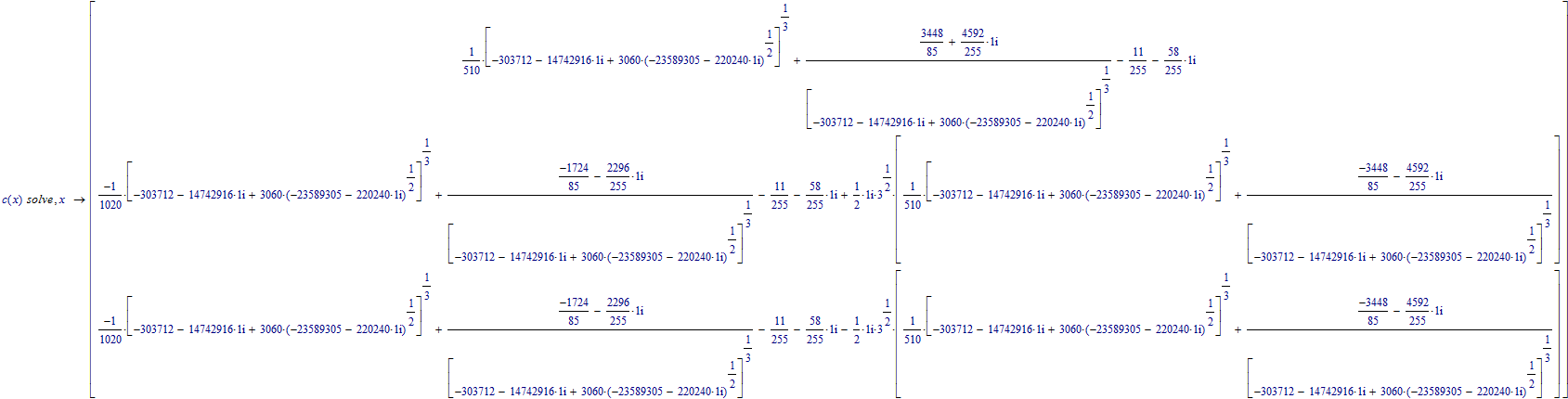

It ends like:
Just a specific example:
The full symbolic solution is:
Liv7-BedrockAuthor
7-Bedrock
March 1, 2017
Oh, ok,  it's an idea !  Thank you !
Forgot completely that there is symbolic calculation available. Should have thought about....
I'll try to make that work for my application.
(For the sake of completeness, let me recall polyroots function, which is able to provide the roots for both real or complex coefficients cases).
However, still curious about relations given in the mentioned Russian journal.
You got it in Prime or Mcd15 ? If in Mcd15 how u managed to display all that when solving w(x) symbolically for roots, because I'm getting in Mcd15 the message " The symbolic result returned is too large to display, but it can be used in subsequent calculations if assigned to a function or variable " .
Best, Liv.
23-Emerald V
March 1, 2017
This was done in Mathcad 11... I can have my symbolic results virtually as large as I like. I believe that facility was not supported after Mathcad 11.
But in Mathcad 15 you should be able to use the results, even if you cannot see them.
In case you have a specific equation you want the full symbolic result of, I can do it and copy that to another expression. Then you can use it in Mathcad 15.
